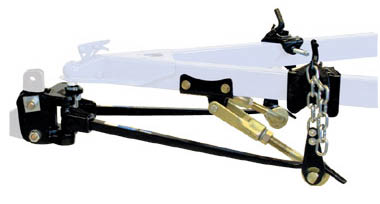

    I have this on order:
    Reese Straight line 1200
    The hitchbar I am going to use is a 2 1/2" and is 15" long so I am hopeing if/when I get a slid in camper I will already have the clearance I need waytogo

    That is a sweet WD hitch!.....That will solve any potential problems....I hope your slide-in is reasonably light - lots of weight for a SRW!...how much does the K5 and trailer weigh?
