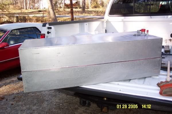

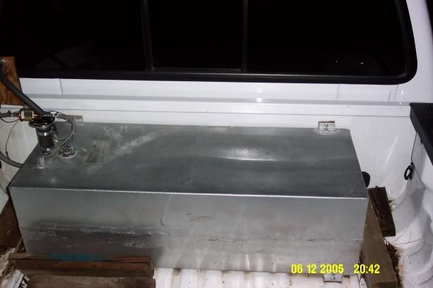

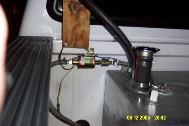

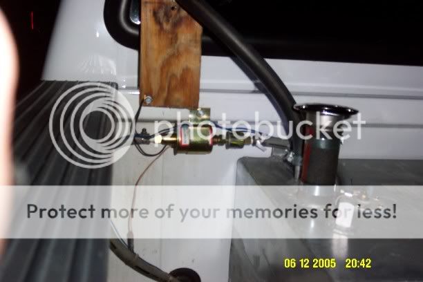

    I installed a 50 gallon tank in the bed of my F-350 so that I can buy fuel in SC as it's 15 to 20 cents a gallon cheaper down there. I have to go there every month to 6 weeks anyway so I can pull my 5th wheel down there for a week and top off the 38 gal main tank and 50 gal aux tank and that usually lasts me till my next trip down.

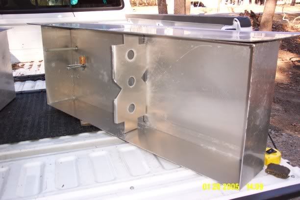

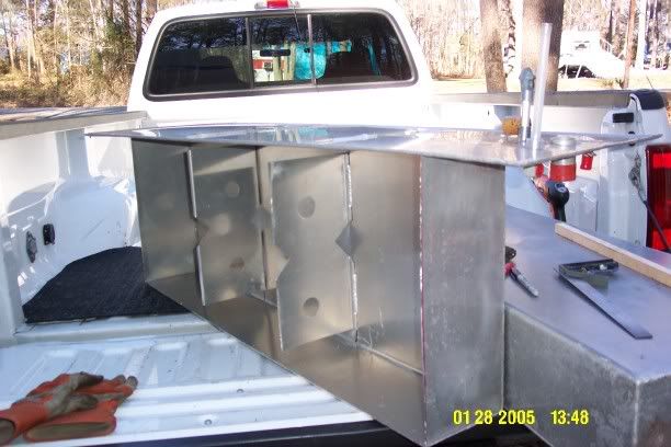

    I made my tank out of 2-27 gal aluminum marine tanks that I bought a couple of years ago at a thrift shop for $35 ea. These tanks had never been used and I cut the top out of one and the bottom from the other and welded them together.

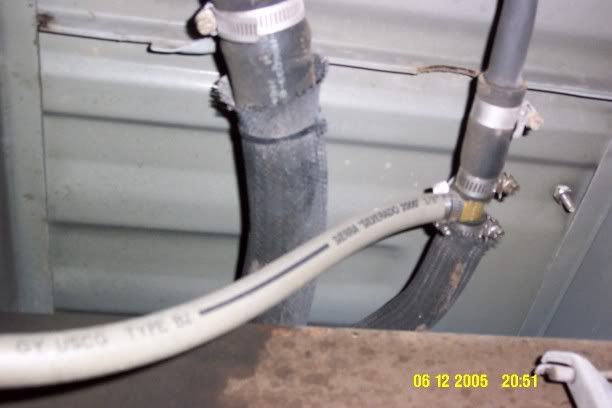

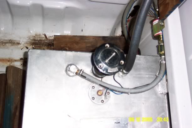

    A 32 gallon/minute pump transfers the fuel to the main tank via the fuel filler vent hose. I also installed a fuel gauge but it is pretty unreliable. My original vent left much to be desired as it would slobber fuel and so I changed the vent and connected it from the aux tank filler to the main tank filler and now when I leave the pump on too long the fuel returns to the aux tank instead of overflowing out the main tank filler cap.
    Don't ask how I know about leaving the pump on too long, while transfering fuel the first time I left the pump on while parking the camper in NC and got out to check something. While walking back to the truck fuel started pouring out the filler and I had to run to shut the pump off. Lost about a gallon on the ground. From the start I wired the pump through the ignition switch to a lighted rocker switch thinking that the red light would remind me that the pump was on...it didn't.
    A couple of weeks ago I stopped at a hardware store and told my old lady that I'd be right back, since she didn't want to go in I left the truck running. She called me on the cell phone to tell me that the fuel pump red light switch was on, should she turn it off. Hell yes, turn it off...I screwed up again but at least it didn't overflow. One problem is that the main tank fuel gauge is slow to react when tranfering fuel so I shut the pump off when the gauge reads 3/4 and after a while it will climb to past full.
    On edit... I spent about $125 on my tank install with $50 of that the fuel gauge and sender.
    Good Luck,
    Old Trucker

    Here's some pictures of my set-up. The vent in the piece of plywood is no longer there.
    I resized all these pictures to the same and yet the first 2 still remained large...Sorry.

    Pictures from when I made the tank out of the two.
    Old Trucker
